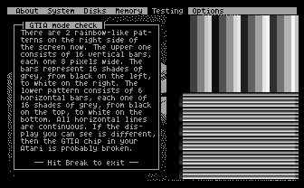

Der GTIA-Fixer von Simius behebt nur den GTIA-Bug Typ 1, der GTIA-Bug Typ 2, den z.B. Floppydoc und meinereiner in ihrer Sammlung haben wird damit nicht behoben. Beim zweiten GTIA-Bug kann man angeblich Pin 35 des Antic mit Pin 28 des GTIA verbinden, um den Fehler zu beheben.
GTIA-Bug Typ 1: GTIAbug1_small.jpg
GTIA-Bug Typ 2: GTIAbug2_small.jpg

GTIA-Bug Typ 1 sind XE-Computer made in China, dieser GTIA-Bug wurde als erstes entdeckt (ist aber neuer), laut Atariki sind es diese: "Defective layouts are those with a production date of 9035 to 9152 (this is the number placed on the right side of the AMI symbol, the first two digits are the year of manufacture, the next two - the next week of this year). This range of dates includes systems in which a defect was found - it is possible, however, that in fact all systems produced between 1990 and 1991 are defective. A probable cause is some minor changes in the technology of making later systems produced by AMI, which caused some signals to be moved into dangerous or unstable time ranges. "
GTIA-Bug Typ 2 sind überwiegend XL-Computer (und zum Teil auch XE-Computer), dieser GTIA-Bug wurde als zweites entdeckt (ist aber älter), laut Atariki sind es u.a diese: " The systems with this defect come from earlier years than those with a defect of the first type: it was found, for example, in systems from 1983, 1984 and 1987 (dates 8339, 8351, 8442, 8722). This does not mean that all copies with these dates are defective. "
